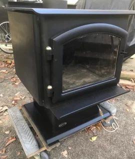

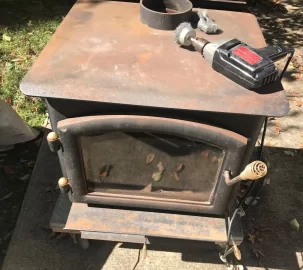

I got a 15 yr old stove off Craigslist that needed to be refinished. After using a wire wheel to remove all the rust, I wiped down the whole thing with acetone before 3 coats of Stove Brite paint. The next day (still outside) I lit a small fire for about an hour and baked on the new paint, and after it cooled the smell was pretty much gone. After about 4 months of use the paint still looks new.

Reactions: marty319
