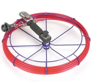

Bholler Is this the Viper you have ? Why do you like it?
Why do you use the flat bristle brush instead of the poly? I have a lightwall liner so don't think I can use the steel brush.
[Hearth.com] Cleaning your chimney
No ours has a stand i dont remember what model. We like it because of how flexible it is it is really easy to clean from inside with it. We still use rods and brushes on some and rotary cleaners on some but on new stoves with good conditions in the staks it works well. And we use the stainless brushes on light wall to with no problems they are very flexible and don't harm the liners. But some liner manufactures say not to use any metal brushes so check on yours but we have been using them for over 10 years and have never had an issue
Is this the one you have? Why would you ever still use rods?
Yes thats it and we use rods if cleaning from the top i think rods from the top are easier that using the viper from the top and if the chimney is really dirty the viper brushes don't cut it.
I'm really tempted but they are pricy. I think I can get the 50 footer for about $350 plus brush.
There is no way I will clean the 25 foot flue from the roof and the sooteater would be way to much of a pain.
I dont use a soot eater it would not hold up to the amount of use we would be putting it through. Top cleaning for us is usually with screw together fiber glass rods and a brush. Our rotary cleaning rods are 1/4" steel and we go through them in a year. But they are also used for liner break out which is hard on them. And yeah vipers are pricey for a homeowner i dont think it makes sense to spend that much for a homeowner but that is my opinion and i am cheap lol.
So what would you suggest for a homeowner who wants to clean from the bottom a 25 foot 6" slightly ovalized lightwall liner?
probably the soot eater But if you are willing to spend the money for the viper it is a very good system i am not saying you shouldn't get it i just think it is allot of money for something you will only use once or twice a year.
