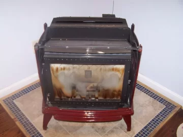

    Here are a few pictures of what i clean on my Enviro Empress

  17. livefreeordie
    livefreeordie
    Member 2.
    Nov 21, 2010
    203
    4
    Rochester, NH
    I have more pictures but this forum won't allow me to post more, sorry
  18. livefreeordie
    livefreeordie
    Member 2.
    Nov 21, 2010
    203
    4
    Rochester, NH
    more picutres
