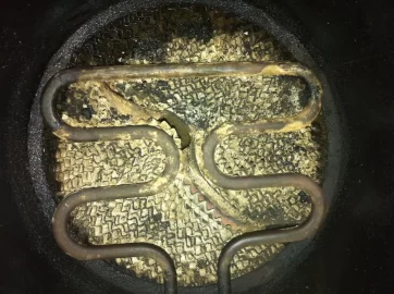

My father law and a good friend both have them now and are having issues with them plugging up.

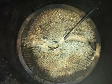

Here is a picture of the inside of the catalyst from clear stak that we removed from my father in laws stove last weekend. It plugged and would not burn any longer. This was installed in late september.

I don't see any possible way that a catalyst would be able to handle the volume of emissions and particulate matter commonly seen in an OWB. Throw in the fact that most users are "burning" green wood and it's just not going to happen.
I can see this working in some instances on a gasification type boiler but most catalytics need a pretty decent temperature to get them lit up......That electric element would have to have pretty high output.

The element is suppose to get it to 1200 or so degrees before the control board allows the damper on the OWB to open. In my father in laws case he is burning dry wood that is 3 ft long and split in half. The moisture meter say 16-21 when i tested it in sept.
He stay atleast two year ahead on wood, retired and nothing better to do i guess.
Anyhow once the damper opens the heating element turns off. The fire is suppose to maintain the catalyst at that point.
Not sure how that is possible with the temperature of the fire in this poor technology type stove.
