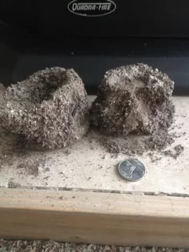

this is what I am dealing with:eek:
Holy cow!?! Those look like fallen soufflés! Is that a current pic, or is that a pic of the clinkers that made you start this thread?

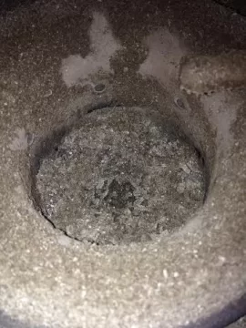

Well I spoke too soon. Came home from work yesterday to an overflowing burn pot. How could this be. I just did a cleaning with a flue cleaning. I shut down my stove. Dumped the burn pot only to find that almost every hole is packed and glazed over with what I can only describe as a giant clinker that encapsulated my burn pot. Strange. Been fine since.
that is current and what started the thread, getting ready to pull another one out as soon as the stove cools down. I'll take a pic of the pot before I remove it
