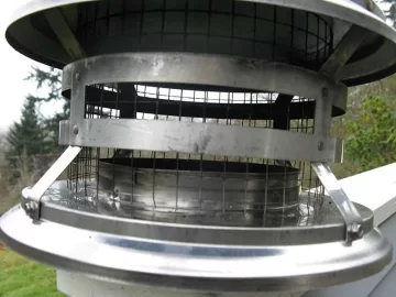

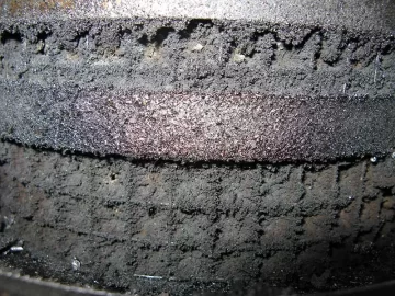

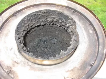

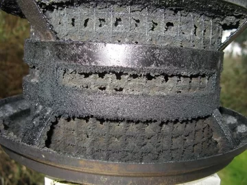

This is what a clean cap looks like: [Hearth.com] Clogged cap And this is what I found. [Hearth.com] Clogged cap [Hearth.com] Clogged cap
The accumulation in the pipe wasn't too bad. Just about 3/8" of fluffy stuff, but the cap was gross.
My wife reminded me that we had some burn time from last year so this is more like 1.5 cords worth. But I'm fairly certain that most of the accumulation has been since fall. I checked the cap last summer and it looked pretty good. Highbeam will be happy to note that I pulled the screen and am going to finish out the season without it. If birds get to be a problem I'll put it back in or I'll bag the pipe for the summer.

Wow that looks seriously clogged! Your screen is way too fine I believe my screen has slots 3/4"x 1" (not 100% sure) ..Have you considered getting a coarser screen? My screen looks like this BG, (broken link removed to http://www.woodstovepro.com/store/M-G-DuraVent-9-Ventinox-Bird-Screen-RCB-9-p16437.html)

Since you brought my name up, yes, I have seen something similar though in my case it was brown and light where yours looks black and wetter. We have the same simpson caps but I don't get any of that now that the screen is gone. No birds, rats, or chimpanzees have ever tried to climb down my flue.
It is amazing that you could even burn a fire with such a restriction at the cap.

You've got that right. I couldn't burn without a lot of smoke coming back as soon as the door was open, even just a couple inches. It's amazing how now the stove just takes off. Top went right to 675 with 5 splits in 30 minutes. I had forgotten how eager the stove is to burn. Funny thing is I have burned with a screen for the last 15 yrs or so. This is the first clogging.
