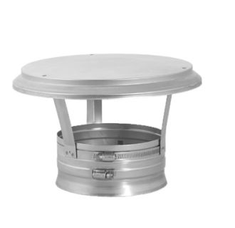

OK, here's the fugly truth.
This is what a clean cap looks like: View attachment 89838 And this is what I found. View attachment 89840 View attachment 89841
The accumulation in the pipe wasn't too bad. Just about 3/8" of fluffy stuff, but the cap was gross.
My wife reminded me that we had some burn time from last year so this is more like 1.5 cords worth. But I'm fairly certain that most of the accumulation has been since fall. I checked the cap last summer and it looked pretty good. Highbeam will be happy to note that I pulled the screen and am going to finish out the season without it. If birds get to be a problem I'll put it back in or I'll bag the pipe for the summer.

great post Begreen thanks for sharing. i stfa for "chimney cap removal" search and found this. Are there any issues with just running the chimney without any cap whatsoever? my installer recommended I remove my cap -- pie plate style no screen like this one....
to reduce the yellowy creosote milk shake thats forming on my storm collar. yea my wood is a little wet, moisture meter reads around 18-20% on a fresh split but the pea colored creosote on the storm collar says otherwise.
