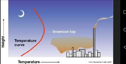

Maybe not expertise, but I've experienced somewhat similar types of situations, where outside conditions have contributed to backdrafting. Usually, the conditions are calm, humid, with a pronounce rise or elevation in temperature. Air inversion may be a possibility. Pilots call it heavy air. A look at fog or smoke outside that appears to flatten into layers would indicate an inversion. If the layer is at or just above the top chimney level, then air escaping through the layer becomes difficult, and backdrafting is a real possibility. Look outside - smoke rising, fanning put, or immediately dropping to the ground all indicate different extents and locations of layering. My stove usually has excellent draft. But sometimes, very rarely, the conditions are just right that lighting the stove is a real chore, with extra time spent initiating and maintaining enough draft to keep smoke out of the house. A couple times I've almost abandoned trying to light the stove because the outside air was so heavy and was seriously blocking any draft. I've never noticed it later when the stove is warm, at least enough to set off any alarms. That doesn't mean it wasn't happening, just that the co alarms haven't indicated it.
  • [Hearth.com] CO alarm
