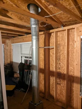

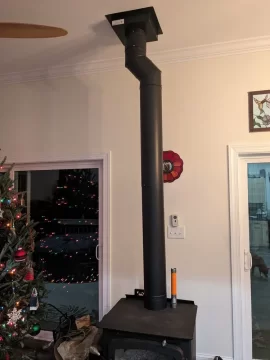

Below are pictures of the flue, which goes from the first floor (10ft ceiling), to the second floor (unfinished attic), to the chimney on the roof. The whole thing was installed by the original builder of the house. During my first chimney sweep, I was informed that the pipe on the first floor was incorrect material for a wood stove and needed to be replaced. I replaced it myself with DVL double wall stove pipe, which is what is shown in the picture. I used the same configuration/layout that was there originally (e.g., two 45 degree pieces).

The install looks straightforward. One thing to check is the cap. If there is a screen on it, that should be examined for buildup that might be weakinging the draft.
The bath fan, a radon fan, a competing appliance like a gas or oil furnace, could all changed the balance. With the next fire, open up the patio door 1/2" and see if that affects the fire. If so, it looks like it would be fairly easy to add an OAK to this setup.
