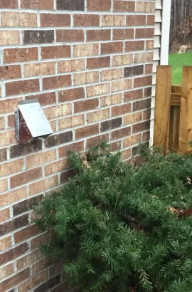

COLD AIR EXCHANGE EXPLANATION??? COLD AIR EXCHANGE EXPLANATION??? Don't forget that your OAK should end with some kind of screened cap...not only to keep out the little fellows like Chippy's but even hornets/wasps. Good to add the annual....Check the OAK for obstruction/clean screen.

On another note, if you are handy, most hardware store have 3" rigid aluminum dryer vent that works great. They will have elbows 90*, 45* and straight lengths along with bug proof end caps. This is what I used. I think I spent $12 all together. Screwed it together and rtv'd it. If your stove has a 2" inlet you might have to get creative with the adapter. Just remember it needs to be. Non flammable, so don't use those expanding dryer vent or any other dryer vent other then some kind of ridgid metal.
