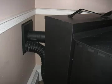

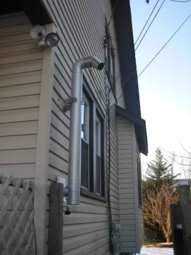

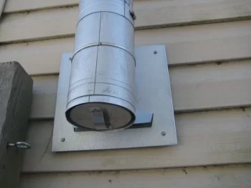

Simple OAK setup from inside to outside.
Horizonal Air inlet is Behind the outside bottom cap.

All incoming air is warmed by the exhaust so no reduction of efficiency on very cold nights.
I do not see how this is possible.
Let me try to explain as best I can (I am not an expert): It's a feature of the direct vent solution - as the hot exhust is going up thru the 4inch inner pipe, the fresh air is pulled down using the same pipe as it has an external 1inch evelope. The cold air in the envelope is then heated by the inner exhust pipe and is warm when it hits the combustion chamber. Since you are using existing heat from the exhust to heat the air intake and the combustion air is warm vs. cold, you get better efficancy as a result (no cold air in the stove). This concept had been used for years with wood stoves, now also with pellets. I had a regular OAK and converted to this, and I can report visible improvement. I love this pipe!
I know how it works, it's the physics I don't buy. 1300 degree fire affected by air 60 degrees less cold?
I am in no way a physicist, but here is what I think: the key to any OAK is to provide an external source of oxygen to a fire, if the incoming air is warm instead of cold you will spend less energy heating it. It may not be a large difference for a 1300 degree fire, but frozen air would still take some extra BTU's to heat, while warm air has as much oxygen but takes less BTU's away from the fire. As you are re-using the heat you are already sending (waisting) up the flue, you recalim some of that lost energy and heat your air "for free", hence improve your efficiency. This sounds logical to me. Maybe someone here knows the science better and can chime in with a better or alternate theory.
