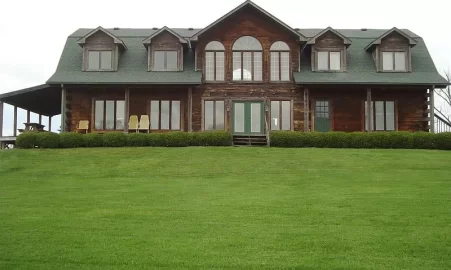

Last year, my wife and I purchased a small farm with a 3600 sq/ft two story log home (2k downstairs, 1600 up). The house has an older geothermal unit downstairs and conventional electric HVAC setup upstairs. The house is very open downstairs, with a large opening at the stairwell for air to rise up to the 2nd level. We want to install a wood stove for a few reasons: 1. supplemental heating to take stress off our geo unit and lower our winter electric bill, 2. heating for when we lose power ( we are off a wooded gravel road and power has been cut a few times) 3. Who builds a big log cabin with no fireplace??
The stove wouldn't see 24/7 usage here in Central Ky, plus I work full-time and wouldn't be able to tend the fire throughout the day. My wife works from home. I am looking for a stove large enough to heat most of the house, but efficient enough and with long burn times that I don't have to get up to add wood in middle of the night. I'm limited on my install locations to an outside wall. House is NOT air tight, I have a lot of windows and caulking to replace over the next 6-12 months. Thought would be that I can start a new fire as I get home in the afternoon, refill before bed and when I get up for work.

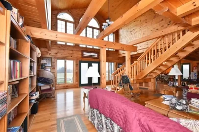

I mainly say limited to outside wall due to what I expect would be a substantial install cost of having to vent through a 2nd floor and concealing the pipe running through a bedroom. We also have a lot of open space in one corner of downstairs where a stove would fit nicely.

I would put the stove somewhere in the great room with the cathedral ceilings. Stoves produce intense concerted heat. Make sure it can be viewed from the space you live in. There's nothing better than watching the northern lights in the stove. I won't make a huge difference being on one side or the other side of the room. The heat will move. We have ceiling fans that move the heat. Take a look at the Jotul enamel finish stoves.

I'm also curious why you are limited to an outside wall? I'd install the stove in the middle of the main floor and run double wall straight up to the roof.

My wife isn’t keen on running the vent up to the cathedral ceiling, plus it really wouldn’t fit well in that area. If we kept it toward the interior of the house I would have to run the vent through a bedroom, floor to ceiling.
exterior wall just seems to be an easier install, and keeps the wife happier for location.
honestly, downstairs is like one giant room, so exterior wall or not is about 20 ft difference. There are 3 ceiling fans downstairs as well, so I could keep the air moving.

I would try to park a big stove right there around the stairs!! Straight up out the roof and the heat will travel up a lot easier than putting underneath the upstairs floor where you have it marked out.
