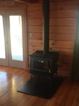

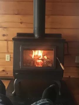

We got our Princess installed today! Loving it so far. Was a bit concerned that the temp gauge is staying pegged. I didn’t throw in a full load to start with. Been adding a couple logs at a time every few hours. Loving room and kitchen are nice and cozy, bathroom and such on opposite side of the house is a cooler, but I hope a stovetop fan can move more air in that direction. Definitely milder temps around here at the moment, around 35-40.
Reactions: ABMax24 and Nealm66
I loaded up about 2/3 full before bed last night, turned it down to about 3 o clock. Still had big pieces going 8 hrs later.
I’ll be honest, the novelty of it right now has me plopped in front of it, turning up the airflow enough to have flames. Is there any No-No’s so as not to damage this thing? I don’t mind being less than efficient with the wood for those times I want a light show, but want to make sure I’m not overdoing it.
