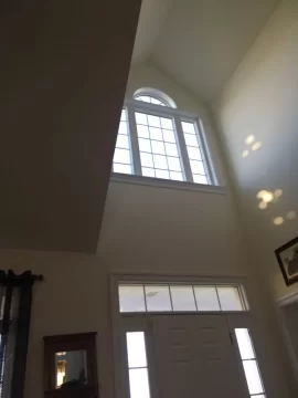

I had One of th side lights on my center cape window shatter on my own in the middle of the night. Low e window, broke inside pane only, on a very cold night. Window is in the stove room. Not facing, 90 deg to it and 25' away.
