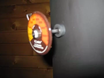

Was it this thread that we discussed the end of the probe being placed in the middle of the flue? This is what Condar states you should do and so I pulled mine out of DW pipe about two inches. When I did this, there was a noticeable decline in temp. Approx.
100deg. on a steady 600.
Curious if everyone runs with it flush to the pipe.
I just pulled mine out about an inch and I'm going to see if it makes a difference. It seems almost impossible to keep my stove within specs which Napoleon says are 250-450 flue temp. Right now my stove seems to like 550 to 600 with my condar.
Trout: You are doing much more than pulling the probe tip to the middle of the flue. You are also pulling the bimettalic coil inches from teh heat source where it can be influenced by room air. The design of this meter depends on it being a particular distance from the pipe. Cut the tip of the probe off to hit the center of the flue if you choose. You must run it flush to the pipe, especially with double wall.
Joey: Many stove manufacturers assume that your "flue temp" is the temp you get when you stick a magnetic surface meter onto the flue pipe. So you can double the Napolean temps to get flue gas temps of 500 to 900 which falls right in the condar recommended operating range.
