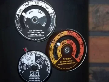

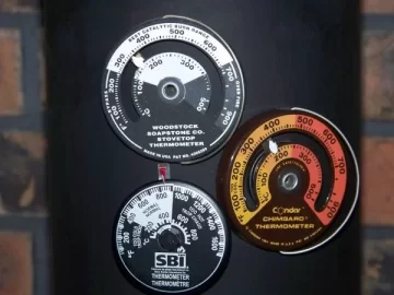

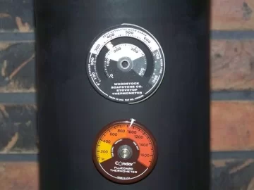

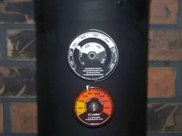

Well since this thread popped up again I might as well tell anyone that may be interested, I went out and purchased an SBI probe that is similar to the Condar. I almost drilled another hole in my pipe to get a side by side comparison for you all but decided against it. The SBI is cruising at 600-700 internal with an external of 250-300. My Condar is reading about 50-100 higher in that same external range. The Condar also seems quicker to run away on a fresh reload once temps get up over 800. Not a huge difference and I'm sure these flue temps would be less in a double wall pipe than my single wall. SBI instructions state this thermometer is for double wall pipe unlike Condar who says it's good for both.

I don't think probe thermometers are accurate "number" wise according to Wes999's tests with his thermocouple, but in my opinion they are close enough and consistant enough to be used as a valuable tool. I also think they are better designed for double wall because the radiant heat off single wall effects the temps.
Personally I like this SBI probe better. The color of the face plate makes it easier to see from a distance and it seems to read a bit lower than the Condar and not run away at higher temps in the beginning of the burn cycle.
