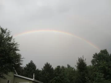

Wasn't planning a picture of the outside.... but here it is with a rainbow. If that helps any.
  • [Hearth.com] Considering a Woodsman Stove
What is that, 12-13 feet? On the short side as most of the new stoves like 15 feet for optimal draft.
