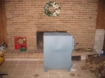

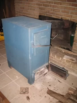

Hi all. I have a couple of questions I hope you guys can answer. I have a very old cast iron woodstove that I inherited 2 years ago. It is vented in the back so I put it in my basement and vented it out the existing fireplace. I had to remove the fireplace flu and I ran 8" black stove pipe the length of the chimney. The 8" pipe connects to the 6" opening on the stove. The chimney is about 25' tall.
Anyway this thing is a monster. It has a fire box that is 3' high, 25" deep, and about 18" wide. It heats my whole house (1700sqft ranch with 1700 sqft finished basement) in Northeast Ohio. When I say heat I mean the immediate area is 85 degrees and the surrounding rooms stay around 75 degrees.

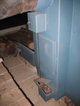

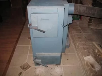

Here are the problems. The thing is ugly as sin. The stove can't sit on the hearth so it sits about 5' out into the middle of the room. The draft is horrible and the thing smokes like crazy when I open the door - probably because there is a 4-5' horizontal run before it enters the chimney. Finally, this stove gets incredibly hot and I have a new baby. My wife doesn't like the burning hot stove in the middle of the room.
I would like to replace this stove with an insert, but it would need to continue to heat a large portion of the house. I am considering the Summit insert. Here are my questions.
Will an insert come anywhere close to heating the home like this big woodstove?
Will the 8" steel stove pipe be adequate for a few more years or should that be converted to a 6" ss pipe?
Does the pipe need to be insulated?

I'd look at several different inserts to see what you like, but the Summit is a good one. I suggest looking at Kuma and Quadrafire as well. Kuma has a monster insert one of my neighbors swears by.
Some other questions:
Is your chimney masonry? If so, what size?
How old is the current wood stove? Was it a non EPA stove (I would tend to think it is)
Is there power available near the hearth for a blower?
I believe in the best interest of safety, a chimney reline with a stainless liner would be your best bet, but it would also be more expensive.
I can tell you I have a Quadrafire 3100I and I heat approximately 1300-1400 square feet of our home with my insert. My home stays at a comfortable 78 degrees with the stove at a low steady burn. On the coldest days (-10 to 0 F) it keeps the house at 75, I just have to turn it up some.

I am not familiar with your stove. My Summit insert heats my home of roughly 2500 sf 2 story with open living room & loft. I have an additional 750 sf addition thats incomplete, which I will be getting another stove for that area. Summit comes with a blower, and most but not all others its an extra paid option.

I had to remove the fireplace flu and I ran 8” black stove pipe the length of the chimney
Will the 8” steel stove pipe be adequate for a few more years or should that be converted to a 6” ss pipe?
First of all that connector pipe has no business being used as a chimney or chimney liner since you removed a flue you also lost flue protection from chimney fires
If the clay flues were in good condition removing that flue now requires a an insulated UL 1777 aproved liner that flue removal cost you about $1000 more to do it code compliant
From the sounds of it you appear to be over firing that beast. no modern stove can compete with overfired beast for heat output. the largest insert I know is a Buck 91 if you feel you need that kind of heat. If you ever had a chimney fire with that single wall pipe without flue protection you would not be typing on this forum Man that is one dangereous situation you described

CODE VIOLATION ALERT!!!!! MAJOR CODE VIOLATION ALERT!!! Black stove pipe is ILLEGAL and unsafe to use as a chimney lining!!! I hope you plan to fix this when you replace the stove. Was the earlier installation permitted and inspected? Does your homeowners insurance know about the stove? (Note that if your home burns because of an improper install, your insurance co. MAY get nasty about paying off. - I'm not a fan of playing "mother may I?" with the gov't on my own property, but in many places it is the current legal reality. - So much for "Land of the (not-so) Free"
That said, what is the existing chimney lining like? Tile? What size? Is it in good shape, or is it damaged? 25 feet should give you good draft, although basement installs tend to be on the inefficient side.
Sounds like an old cast iron pre-EPA smoke dragon, probably eats a lot of wood, and you may be overfiring the chit out of it as well - definitely a good idea to replace it.
I hope that whatever it's sitting on (if not on the hearth) is appropriately fireproof - since you say it's in the basement, I assume it's on concrete (hopefully) I think the kid will learn (possibly the hard way) to be careful around the stove, but I understand the concern. There are many other parents that can point you at stove friendly baby-gates if you feel the need. Note that you may need to extend the hearth, many inserts may stick out of the fireplace a fair distance, and you will need a certain minimum clearance in front to be code compliant.
Insufficient data - how big is the house? How well is it insulated? What is the layout? What is the BTU rating of the old stove, how does it compare to the Summit? However if the old stove was doing the job, the Summit is likely to do so as well. There are bigger inserts, but Summit is in the heavyweight class, and has an excellent reputation You will probably want to get a blower on it, and definitely fix the chimney setup. The PE users on this forum are very enthusiastic supporters of the brand, and I see very few problems with them getting mentioned - However don't beleive them when they say the Whorehouse Red models burn better! ;-P
See above - that pipe isn't legal, or safe. You need to replace it with the proper lining, preferably the one that matches what the stove you are getting prefers - I believe that is 6" for the Summit, not certain. If so, this is good since 6" liners are considerably less expensive than 8".
Depends on your setup as to how BADLY it needs insulation, but my opinion is that insulation will never HURT you, and it is technically required to meet NFPA211 codes. The only reason I see NOT to use insulation is if your setup is such that it physically won't fit. Since you were able to get 8" stove pipe into the flue, you shouldn't have a problem with getting a 6" insulated liner into it. The insulation isn't cheap, but it isn't that much in terms of the total job.
