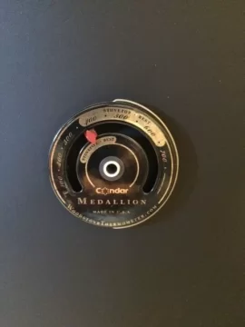

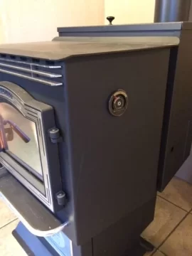

The magnetic thermometers work great, but you are better off sticking it to the side of the stove up near the top, but below the heat exchanger level. Allow 15-20 minutes for heat setting changes when monitoring the temperature. This spot has the least amount of inconsistent readings. The needle stays pretty steady at a set heat level. With my Harman P61A, my needle sits at 350-360* on temp 2, but when I turn it up to 3, temp rises to a steady 410-420* after 15-20 minutes.

Read my post again... Take the stove surface temperature, not the air. Air fluctuates too much.

Having the stove acting like a heat sink allows for more stable temperatures. The temperature of the moving air coming out of the blower changes everytime pellets are discharged into the burnpot.

This is where my temperature readings come from. I can tell when I need to give the interior of my stove a quick scraping. After about about 1.5 weeks of continuous burning, the temperature will drop about 40-50*.
