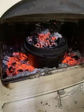

You can always cook inside the stove too. My vote is Pacific Energy.

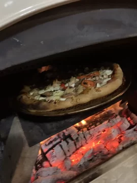

How is your pizza pan supported?
It’s the old damper with the ends cut off and used as legs. I tried welding the cast ends back on for legs and ran out of wire and used a brick on the other end. It’s crap to weld but I got one to stick.
I really like that idea. I'm going to have to think about how to do this with the scrap on hand, lol.
Make the stand as big as your pizza. Direct flame just burns it all too fast.

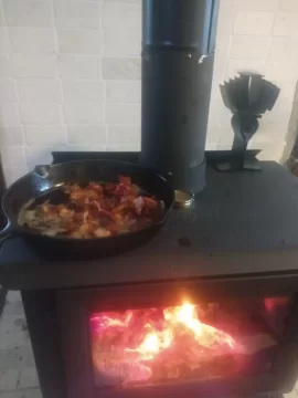

I cook most of the meals in the winter on my PE Summit. It has a great surface area and the natural path of the exhaust make for hotter and cooler parts on the stove top, depending on what I need. An old cast iron trivet helps too. As others have pointed out, inside the stove is also an option. I bought an old tin oven that sits on the top of the stove and we've baked pies and cookies. I looked at the T6 when I was in the market, but wanted a stove that I could do a whole meal on with regularity. I can fit two big pans and a small pot or two. Basically I wanted a big steel plate that would heat up quickly. I can be frying eggs in about 15-20 min after I strike the match.

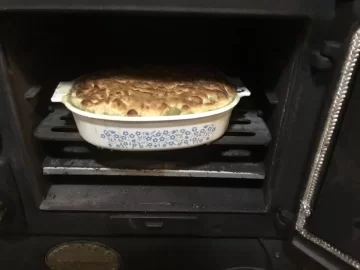

If I were to switch from our cookstove for something with more btu’s and a longer burn time I would be looking at the PE t5. I like the swiveling trivets. After taking a pot pie from our old Waterford Stanley oven last night thoughts of another stove drifted away. I really enjoy cooking and the combination of the cookstove and a mini split do work pretty well for us.
