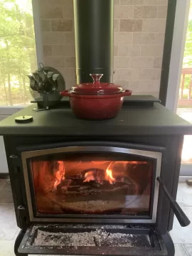

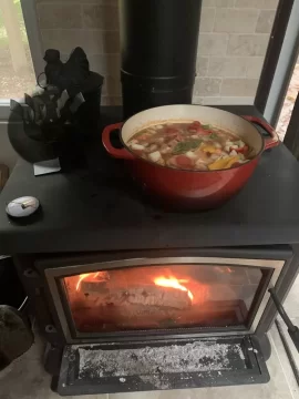

Cooking on our new Osburn 2000, early days yet we had it installed just a month ago , we went for this stove rather than the Oslo because it’s way cheaper and reviews seemed very good for the Osburns, we liked the T5 but hard to find around here so we gave up. We had an old heritage 24 years old great stove but it needed money spending on it. This one is very different, I’m still getting to know it and use it. I didn’t want a catalytic stove maybe I played safe with not always being able to have completely dry wood, and the reviews of the EPA certified stoves put me off, I did the math too. next spring I’m building a proper wood shed and move away from a wood pile with a tarp cover, I got a moisture reader and most of the wood is under 15%
But we are very pleased with this stove, it heats well and the blower isn’t too loud, too much wood does make it burn hot, too hot but I think the silly ash plug is to blame because it smokes underneath when the stove is lit and cold and the door is open, so I’m going to cover the ash hole with sheet metal, I think that if smoke comes out of that ash plug hole then air can be sucked in ?
But we are happy with it so far

It sounds like something like a piece of charcoal may be stuck in the ash plug causing it to leak a bit. Smoke should never come out of there. If anything it should be sucking in air which may be related to the hot fire.
If you get a cast iron trivet for the pot to sit on it will slow down the cooking. This is nice for things that call for a simmer rather than a boil.
