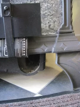

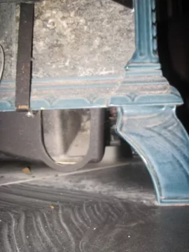

These are the secondary air intakes on my Heritages. I think a foil ball would go a long way here to choke off the air.

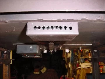

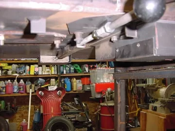

Precaud posted and interesting mod on this topic a few years back. I'm contemplating adding a secondary control to the T6 this season. Initially I'll just experiment with a flat magnet to partially block the port.
That sounds like a good idea Begreen, might be fun when the stove is at full temp when secondaries have been roaring, especially it the inlet is at the back, or worse still underneath !!

Thanks. So does the Super use the main intake port for both primary and secondary air? It would be easy to close off the main supply under the pedestal, but does that also get the secondary supply?
