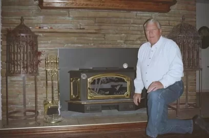

The Lopi Freedom Bay was installed about a month ago. Old chimney had a 14’ long SS flue, 6” in diameter liner installed full length. Good draw and I’ve gone about five days before scooping out the ash. I have a coarse wire chimney cap, but no spark arrestor.
I usually use 1-1/2 tanks (500 gal) of Propane at $2.60/gal. With the use of free hardwood, I should have it paid for in three winters. I like the variable speed blower’ slower speed that allows me to build a smaller fire to heat 1 or 2 rooms. The thermostat automatically cuts on when it’s hot enough, and then when the fire goes lower, it will cut off to prevent blowing cooler air. I almost wish it could set out another 4" or 5" so a full size cast iron kettle filled with water to help with humidity in the house, but I can find a half-profile iron kettle.
A special “Thank You” to the fellows on this forum who helped me with information, choices and shortening the learning curve for a successful start.
Bill
