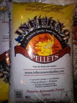

Hello
Inferno Pellets are made from recycled construction material and have a very distinct smell!
However I do like their ad!!!
