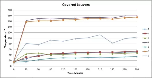

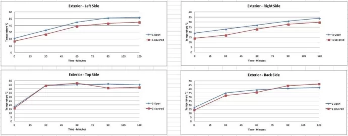

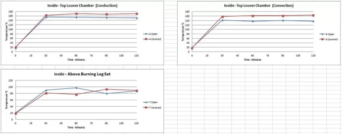

Since I couldn't get a clear answer I decided to run a study to obtain objective data. I strategically placed 7 thermocouples on the exterior of the firebox, as well as the inside cavity of the upper louvers and even inside the burn area just above the log set. Each thermocouple was read by lab calibrated thermometers. I ran the first test with the louvers open and the second with the louvers covered. Each test was run for two hours and temperature was measured in 30 min intervals. I ended up extending the covered test to 5 hours and that data is the 3rd attachment.
Red lines are covered temps, blue lines are open louvers. The hottest temps were all measured in the cavity of the upper louvers. The exterior of the firebox on all sides maintained very low temps in both cases.
Based on my study, I'm not to worried about covering the louvers. Thoughts?

I don't disagree that burning wood would cause it to run hotter. However, it seems that based on the data I collected, the circulation model fireplace is simply for the added benefit of adding a blower and has no affect on the overall exterior operating temperature of the fireplace. I'd be willing to bet that burning wood would yield similar results. But, I'll leave that study to someone else.
