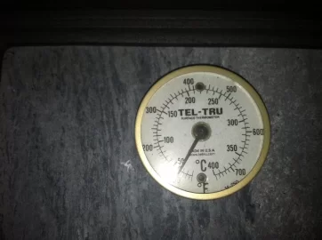

Teltru has a good magnetic therm that doesn't have all the colored burn zones, just a plain Jane white face with black numbers. It seems quicker to react and more accurate than my Rutlands or Condars.

Is this the one, looks nice but I would like to have more range then that.
http://www.teltru.com/s-54-dual-magnet-thermometers.aspx
I can't get my phone to open that link but This is the one I have. It goes up to 750. [Hearth.com] Crappy magnetic thermometers

500 Deg is not very usefull for the stovetop, all my stove tops cruise higher than that. I keep all my temp gauges on the stovetop. I guess its OK for the flue pipe.
Not for me, I like the one he posted a picture of that goes to 750.
