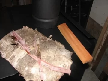

the following pic depicts the defective red wood and what i called birch. might be cottonwood or something.
Definitely birch. Easy to get a fire going eh? bark is the best nature made kindling
Looks like the birch here:

If the cedar is all roughly that size,
be like burning kindling, burn hot & fast.
Should get hot & clean the pipes though.
Have read about over fires, not sure if small pieces cause it or not.
Not reason for severe creosote problems unless it's wet & burned slow.
