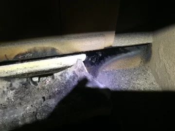

Have a Harman P61A installed in fall of 2007, been burning since. Have learned a lot about the cleaning and operation of the stove thanks to this forum!
This fall has been unseasonably warm here in Southern VT and we haven't been running out stove as hot as we normally would. I got HD pellets this year, Maine Choice, and they are the dirtiest pellets I have burned yet. I have done a full cleaning twice and have only burned 1 ton.

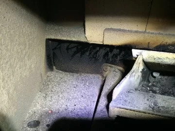

I went to scrape the burn pot today and noticed this, creosote I assume. I did a full cleaning a week ago and there was some around the burn pot but none in the vent pipes.
I've never had this issue before. Am I missing cleaning something? Thanks!
[Hearth.com] Creosote in my Harman?[Hearth.com] Creosote in my Harman?
Could it be an issue with the gasket behind the burn pot?
I'm not convinced that's creosote but.
If it's creosote ( I've seen black carbon too) and for the amount that I can see in your photos ( not a lot, we have had people with the whole stove lined with it), I would think a really good hot burn would melt that off. If it's carbon get out the scraper. If the stove is loaded more than I can see in the photos don't do the hot burn trick. Just my suggestion. I've had small amounts on my burn pot from certain pellets in a low burn and itr was totally gone after a really hot burn. I don't buy those pellets anymore for shoulder season burning.

The only area with the creosote is pictured, right behind the burn pot.
My thought was dirty pellets and continued lower burn temps with the weather having been warmer than usual but wanted some other thoughts.

I edited my post to include that I'm not convinced or at least not sure it is creosote. Creosote has a couple of consistencies it can take on. 1 being tacky goo, the other a super hard and glassy looking shiny glaze. Yours doesn't really look like either one but it's just a photo so I don't want to commit LOL !

It was a bit goo like when I first opened the door to scrape the burn pot. Last week when I cleaned it scraped right off with ease.

Going to run it on higher heat for a wile and see what happens.

So did that goo melt off or burn on with the higher heat level ?
I ran on 75* for about an hour and it started to burn off and turn to ash. I'm still not 100% it's creosote either but it looks like I'm going to have to deal with it this season. Serves me right for going with untested HD crap shoot pellets-dirty and ashy to say the least.

Low short term fires with some pellets and corn will create that sort of mess. I have seen most of my stoves do it except the Elena with the almost full burn chamber lined with fancy firebrick. Spring and fall burns seem to make the most stove and venting mess. Like a car and short trips not getting the engine etc to full temps.
Play with a laser temp gun and one will find all sorts of temp differentials.

If you have some of those pellets left over after this rather warm winter ( thus far) and you buy a good new stash next year , maybe mix these in as you burn the new ones to get rid of these. I've done that with crap pellets in the past and it level the playing field pretty well actually. Or just burn hotter than you like on those warm days. I've had a few lousy batches of pellets, I will never buy in quantity though till I know what they burn like, so they are easy to mix in. If you have 4 tons of crap it's a little harder to do that of course.

I agree above and the warmer weather, low burns, and cheap pellets are all three contributing here. I burn low and slow a lot but I will also ramp it up in the mornings awhile to burn stuff off and clear some ash etc. Low burns are going to create more ash and dirtier glass no matter what pellets are used though.
