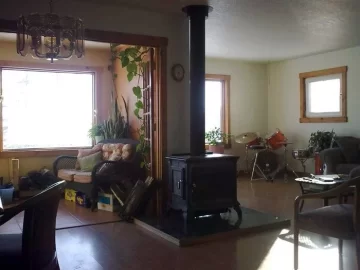

Critique my new installation please
How do you like the 5700? Is it really intense in the living room, or still pretty bearable? It's a great looking install, and I'm sure a lot easier to carry wood to the LR than the basement.
Well I will not be burnaing it the same as I did with it in the basement. It has been in the 30's and 40's this weekend and I can't keep it below 80 in the house. I will probably let the heat pump do the job when it is that warm outside from now on.
The 5700 may end up being too large. I have a hard time keeping the flue temps up without overheating the house. Instead of burning 24/7 like I did when it was in my uninsulated basement, I will probably let the fire go out at night and relight it in the morning, I will start out with a hot fire to warm the chimney before loading it for the day.
I was hoping bigger would only mean more capacity for longer burns and with an east-west load I could burn it clean and long. We will see.
I am amazed at how easy it is to get a fire going. I build the fire top-down with small dry splits and light the kindling with a torch. I never need paper. I get the fire lit in minutes and have a hot fire in 20-30 minutes.
As far as ease in carrying wood, my basement is also my garage, so wheeling wood in near the stove used to be easy.
Oh well, I need more exercise.
Good looking install.! Looks as good as those pictured in the Quad brochures. I can't even fathom how hot it will be in a small room. My 5700 heats the entire house from my basement. Maybe you can make it work. I bet you had more than a little help gettng it up to the main level, right? Keep us informed how she does.

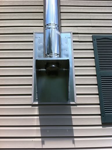

How far out does your soffit extend? I would like to install my chimney around the soffit as you have done w/o using elbows, my soffit ovehang is 10 inches. How far is your TEE away from the outside wall of the house? Does anyone know the maximum horizontal length one can have on a through the wall installation? Your installation looks good!
Technical critique: cuter than a speckled puppy dog under a Christmas tree in a red wagon.
Regarding plants in the stove room, I think that as long as the humidity in the room isn't a problem, they thrive. My biggest problem seems to be their heat-seeking properties, as documented below. All the greenery you see curled around the door frame grew this winter.

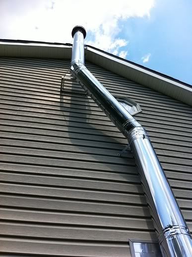

That install look great. The bend in the chimney follows the roof-line, giving it a more natural look, in my opinion. Those never look good anyway, but yours doesn't look bad at all due to the angle. I hope you find that it works well and don't have to change it.

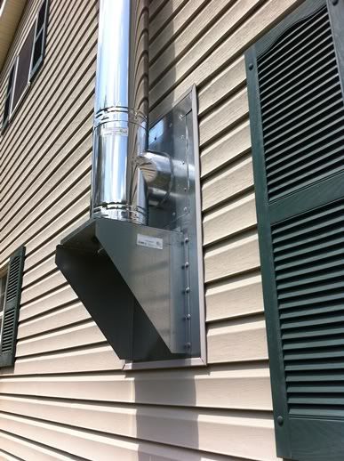

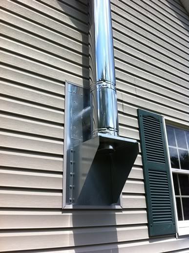

This is a question I am very much intersted in too. The soffit on my addition might over hang about 6 inches - not much more.
How did you offset your chimney to clear your soffit? Can you post some pics of your tee?
Thanks!
Bill
Sorry for the delay.
Here are some pictures:
[Hearth.com] Critique my new installation please
For the tee, I cut the siding, fastened a piece of plywood, covered it in sheet metal, and put J-channel and a bead of silicone around it.
This gave me a weatherproof and solid surface to install the thimble and tee support.
I needed to offset around a window and the soffit and used two 30 degree angles for this. 15 degree offsets would have been better for cleaning, but they wouldn't fit.
My overhang is 12". I used wall hangers from Metal Fab and built the offset at the upper angle out of 2" angle.
