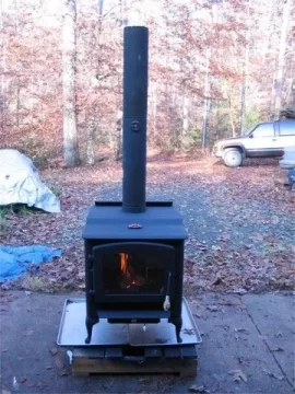

I am redoing an insert and when the temps get warmer I would like to paint it and then do a couple burns in my driveway to cure the paint.
Has anyone done this? Do I need to attach a liner to it for this process or just leave the top open?

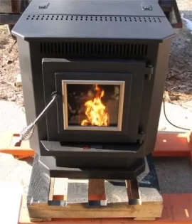

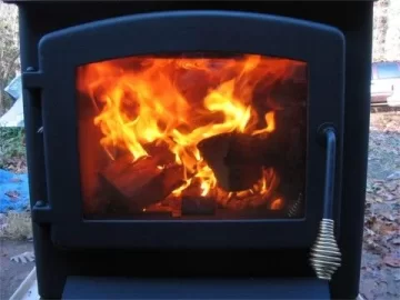

Done it with three stoves Well, more. Five coats of paint with a cool down and re-fire after each coat.
[Hearth.com] curing a painted stove in the driveway question [Hearth.com] curing a painted stove in the driveway question [Hearth.com] curing a painted stove in the driveway question
Reactions: CrufflerJJ
Gotta have a pipe on it. You will have to leave the door cracked open to get a draft anyway. Without some sort of chimney you will have a heck of a time even getting it hot enough the cure the paint.
But it can be done with a piece or two of stove pipe.
I used three 24" pieces of single wall pipe on my stove when I cured it outside. I actually got a pretty good draft going since it was in the low teens that day. You might want to avoid running the pipe through the basketball hoop. It will get pretty hot, likely hot enough to scorch or melt the paint on the hoop/backboard. Three screws at each joint should be plenty to keep the pipe upright.
