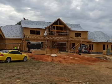

Here is a pic of the house so far. The plan was to put two copper caps on the two chimneys right in the center of the house.

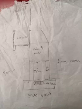

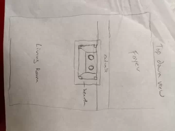

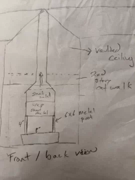

Here is a shoddy drawing.

I can tell you the sheet metal smoke chamber area is going to need to be insulated and the chimney pipe will need to be enclosed in a chase.
I cannot imagine how much wood this thing would chew through. The smoke would be like a cruise ship.
Reactions: bholler
I just looked it up and the glass you will need will be 8 to 10k
Is chase the fire resistant block?
No just something outside the clearance to combustible range of the chimney that prevents anyone from touching it. The amount of insulation needed in the smoke chamber area will need to be figured out by your engineer again because there is no code precident.
Reactions: Awshin
