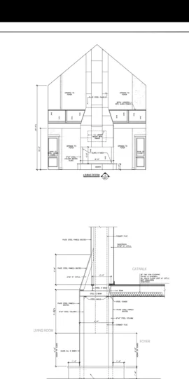

Custom gas assist, island, wood fireplace... Thoughts? Suggestions?
I think you will find yourself spending all of your free time processing firewood. A glass box makes a poor heater.

It is literally a center piece that divides the rooms. I burn only for the mesmerizing effect - and I don't get that from propane. Plus I live in a moderate climate.
Then a $50,000 sculpture it will be. I get the same effect from my smokeless outdoor firepit.

If I were in your shoes with a $50,000 hole to fill it would be a beautiful masonry heater with a big glass door that could be used for baking and cooking. You only have the footers so far, perhaps there's a better direction to go in that won't require your home inspector to be a materials engineer.

No just something outside the clearance to combustible range of the chimney that prevents anyone from touching it. The amount of insulation needed in the smoke chamber area will need to be figured out by your engineer again because there is no code precident.
I'm pretty sure his sketch has the intention of the chimney(ies) being enclosed in a chase.
OP a chase in this case is just the part of the "chimney" that you actually see. If you run multiple class A chimney pipes (you might consider them flues) then what you enclose them in is a chase. Again like someone posted above it might not actually be possible to have multiple class A chimney pipes venting a single fire due to possible draft reversals in some of them.
You are also showing your air intakes as pulling air from the house. This fireplace will pull massive amounts of warm air created by the furnace into the fire and out the chimney. I would look into providing outside air and it will probably even be a necessity if your house is sealed up tightly to modern codes. Whatever fireplace builder you hire should address these things.
Also as you've seen you'll get several skeptical responses here because open fireplaces don't provide any usable heat to a house and many are net heat losses. I understand that you probably don't care about the actual heat output from your fireplace but this forum has a focus on wood stoves and the amazing amount of heat they can provide.
Thanks. Can you buy a single, large insulated chimney pipe?
I wish I had thought of creating an air intake under the slab. At this point, that ship has sailed. I wonder if you could pull at least some supplemental air from the roof down the chimney outside of the insulated tube?

I dont think you could pull outside air from the roof as its possible to start acting like a flue although gas fireplaces pull combustion air from pretty much the same height as the exaust vent. It might be possible to hide a duct along the catwalk and pull the air from somewhere lower than roof.
Your chimney designer could insist on breaking a trench through the slab, I dont know. The best we can do is educate you on questions and concerns to ask the designer/engineer for your beast.

Yes you can buy large chimney pipe. But at the size you need it will be a custom order there are several companies out there that can do this but you are going to pay allot for it

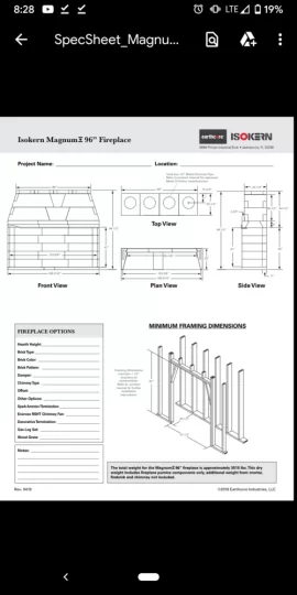

What about taking the upper portion of this fireplace and setting it on top of horizontal metal beams above the glass?
That would be something to ask that fireplace manufacturer about. They would have to give you written approval for it to pass code.
I found one from isokern that is large. Up to ten feet in diameter. They use multiple pipes though. Seems like I could possibly just use the top portion of this unit.

I did just see that this is a gas fireplace though.
The photo looks like an old school open fire pit with an air handler hanging over it. At least with gas it can provide heat instead of just being an eyesore.
