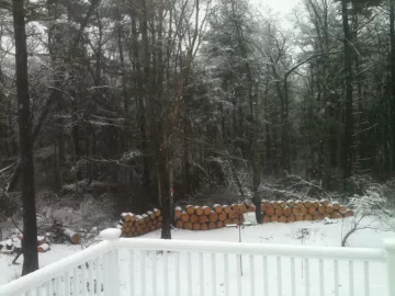

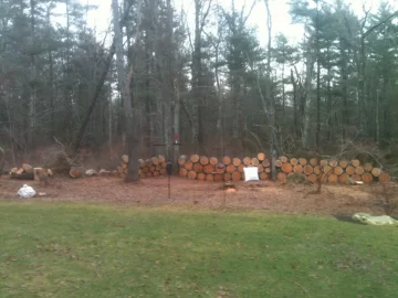

My neighbor and I have cut down and burned about 175 red pine between our houses because they turn into telephone poles. They burn great with little smoke.
