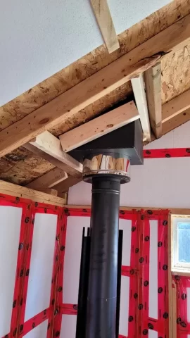

Damper and saving some wood?
hearthon
Dec 6, 2019
225
hearthon
I'm going to support it tomorrow and it's already bit supported with the 2x4 around the ceiling box. I just need to put another 2x4 in the gap and screw it in.
bholler
Chimney sweep
Staff member
Jan 14, 2014
32,291
central pa
No I'm going to leave it for a bit, when I put up plywood I'll try and trim it to fit better. My roof is going to need to be replaced in a year or two so I'll probably just replace the whole support kit. Buy another box, bring it down more and support it nice and clean.
It really needs fixed. And should only take 20 mins or so.
bholler
Chimney sweep
Staff member
Jan 14, 2014
32,291
central pa
No you need to either add a new framing member running the whole height of the roof next to the box to replace the one you cut. Or double up the next one run cross framing that properly ties into the cut framing.
hearthon
Dec 6, 2019
225
hearthon
I'm going to double up the 2x4 going horizontally which will support it nicely.
bholler
Chimney sweep
Staff member
Jan 14, 2014
32,291
central pa
But you are then putting the load that should be spread across 2 framing members onto the center of one. It isn't the right way to do it.
hearthon
Dec 6, 2019
225
hearthon
No I would be spreading out the pressure on the two rafters left and right.
hearthon
Dec 6, 2019
225
hearthon
This is going to incorporate the rafter I cut out and also get help from the other two rafters.
EatenByLimestone
Moderator
Staff member
Tight fitting joints will give you better mechanical strength also. That board going left to right isn’t tight on either end.
hearthon
Dec 6, 2019
225
hearthon
Ya I know, the only problem with that board is that I screwed everything in front the inside of the box out. So I can't even take off any of the 2x4s that are already in place, all I can do is brace it more.
I honestly need this to last 2 years and after that I'll replace the shingles on top and the plywood that I cut into. I want to put a rock wall behind the stove in the future but can't because I'm almost at min tolerance.
brenndatomu
Aug 21, 2013
8,109
NE Ohio
He yelled at me alot in the beginning but lately has been pretty nice ;)
After seeing that framing pic I guess I can see why...that chimney is being held up by a lick n a promise.
A couple more 2x's, some construction screws, a measuring tape, a framing square, and a couple hours could make some huge improvements on the structural strength of your roof/chimney there.
You're sneakin up on it...just keep after it. 👍

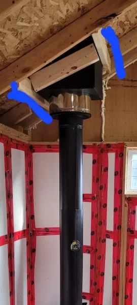

hearthon
Dec 6, 2019
225
hearthon
Just finished reinforcing, now it has 2 2x4 with who knows how many screws all screwed into the rafters. I bet it's stronger right now than when I first started.
begreen
Mooderator
Staff member
Nov 18, 2005
100,833
South Puget Sound, WA
Shouldn't the support 2x4 be aligned to the roof angle instead of poking out below the ceiling rafters?
begreen
Mooderator
Staff member
Nov 18, 2005
100,833
Yes it should, but the nails from the shingles wouldn't allow me to put it flush.
That's got to be fixed before the ceiling goes up.
