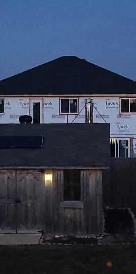

Thank you very much, I have one more break in burn to do today and then tomorrow ill be running it over 500f and see how she runs. I'm in a high wind area with nothing around except houses. And my pipe is for sure over 2 feet from my roofline, maybe even e.

The chimney needs to be at least 2 ft over the roofline 10 ft away.

Ya mine is not 10 feet away but I think I have a good draft
It looks like your chimney top is above 2 ft above the roofline. If it drafts well enough at 45 or 50º for good secondary burn, then that's ok.
