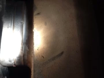

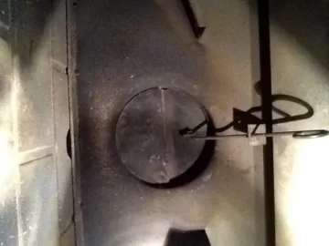

I want to clean my chimney and run the brush from the bottom up. Problem is the blade type damper is in the way. I don't want to destroy what we have and cannot see any way to remove the damper........
[Hearth.com] Damper removal [Hearth.com] Damper removal [Hearth.com] Damper removal
Any suggestions or thoughts?

they usually dont come out you need a brush that is flexible enough to get past itor a soot eater or something like it

I'm running the plastic/poly brush so maybe if I remove the damper handle I can get it squeezed past without ruining either one

not if it is a stiff poly brush you will break something before you get it past

It's the Rutledge poly brush, seems pretty flexable, I'll give it a go and see if I can work it up past. If not back to the drawing board. I may be able to "oval" it slightly just to drop out one side pin. I only need about 1/16 of an inch play to get it free
After looking thin morning I was able to use a long handle screwdriver and gently pry a corner loose and wiggle out the plate! Run the brush up and down a few times and I'm back in business. Went on the roof to clean out the debris from the cap and noticed that I could just as easily remove the top and go top down on it. I didn't remember how it was on last night and since its 37 and drizzling I didnt want to be up there longer than I had to. I'll have to log that away in my head for next time.
