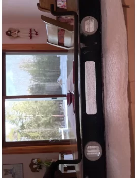

on this site and others shopping for new stoves. I had to take things apart to see if I could diagnosis the issue with the damper as this stove is my primary heat source. I discovered the damper rod was bent out of shape. No force was ever used on the damper handle to cause this the rod to bend like it did. I bent the rod back to its original form re-installed and now is working fine. However, I'm afraid this will occur again, heat related distortion maybe? Attached is a pic of the bent damper rod.
