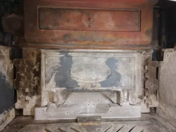

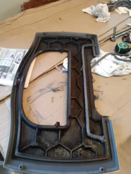

I ended up going through the stove and taking inventory of what I needed. I did not go with the rebuild kit, beacuse the fire back was in good condition, and I didn't think it was necessary to get a whole new damper. I did need a fountain assembly and the shoe assembly. Still not cheap. I got those parts through Mountain View Hearth in Montana. They had the parts shipped to me almost immediately. The stove was back together and running in a few days. Got all my rope gaskets from a local stove shop. Their supplier did not have the other parts in stock that I needed. Figured I would get some pics up for everyone of the rebuild. She's been running great for a month now. I won't be doing that again. Possibly looking into a Jotul F55 in the future.
