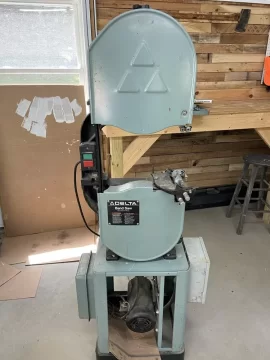

I was given a Delta model 28-303 bandsaw that can cut metal and wood. The issue is that it is 3 phase. I do not want to buy a converter because they seem very expensive. Is it possible to buy a harbor freight replacement motor that is single phase. I would just have to make sure it has the correct HP and diameter shaft.
Any advice out there?

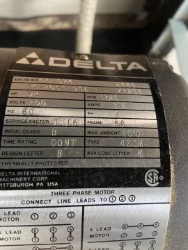

How 'bout posting a photo of the tag on the motor? Do note that there are some motors made 1990's into early 2000's that might be 1.25 hp but labeled as 7 hp. I own a CH compressor and a JET bandsaw, both of which fell into this bit of manufacturer specmanship, a practice which I believe might have been outlawed in the years since. If you have any doubt about the true horsepower of your motor, go off the FLA, as the standardized tables are widely published.
Checking amps off the tag will let you know if you have marketing based hp numbers. Figure you need 15 amp/hp.

I guess it's only 3/4 HP. I am assuming that I can find a 3/4 HP replacement motor that will run at those rpms and still be 110v.
[Hearth.com] Delta Bandsaw [Hearth.com] Delta Bandsaw
That’d be no problem to run. You can find that motor on any appliance.

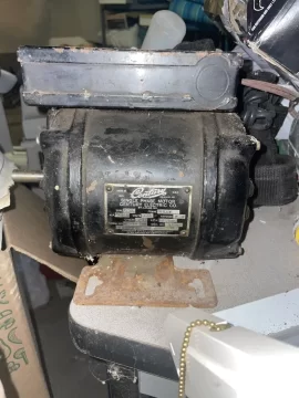

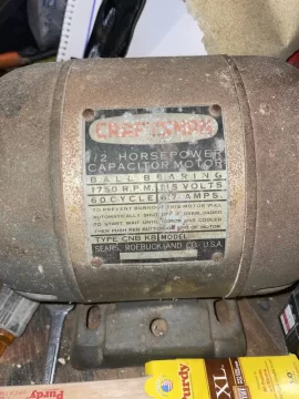

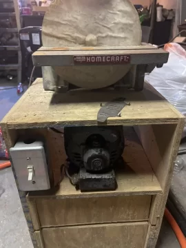

But there are lots of old, used motors laying around. Just in my basement, lol
Those are all scrap motors . It’s a grab them when you see them. They can be used to make grinders, power a disc sander, etc,
