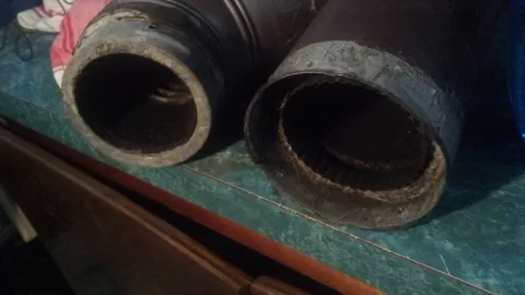

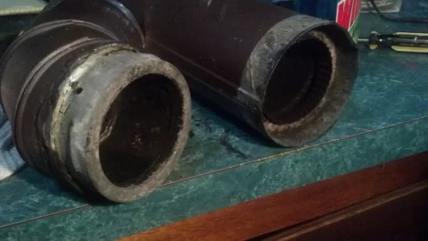

Take some close-up pics of the ends.....we might be able to identify it that way.

I have attached pictures of the ends. Hopefully, somebody may know what exactly I am dealing with here. [Hearth.com] Determining Chimney Vent pipe brand?

Doesn't appear to be PelletVent.
That looks like CLASS A chimney pipe - typically used for wood/coal stoves.
Depending on installation method - it is possible to buy the adapater from PELLETVENT piping that transtions to CLASS A chimney pipe.
Typically you would not want to mix brands in general - due to safety.
It's only 3" pipe... do they make class A that small? I know for certain it was installed with a pellet stove because I got the pellet stove with it for free.

Definitely doesnt look like selkirk or duravent.
And no I've never seen CLASS A 3" so strike my earlier comments.
That is James A. Ryder pipe which is now Selkirk PL vent has the same twist lock connection. It always leaked. 20 year old design.
