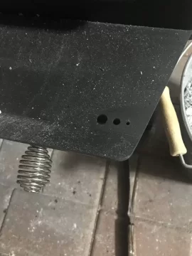

Thank you for the correction and clarification.On my Escape 1500, I do not have three holes drilled into the front lip over the air control knob.

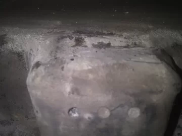

I do have three holes on the inside of the stove, in the doghouse. (Doghouse being the lump which is centered in the front lower section of the firebox.) These holes only receive air when the primary air control is more than about 3/4 shut. When primary air is only partially shut the small intake hole is covered. With the primary air completely open to about 3/4 shut this hole is covered.

The three holes feed air directly into the firebox. My guess is that those holes supply air to help keep the fire burning when the primary has been shut down. Some people have plugged one or more of these holes to improve their stove. I am considering enlarging the small intake hole and developing a way to control the air flow thru that hole.

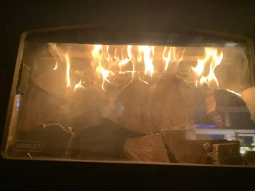

View attachment 320296 View attachment 320297 View attachment 320298 View attachment 320299

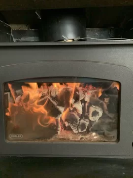

  Three splits on a 200 STT  with my 1800i will spike  the flue temps but STT won’t go over 500. ![[Hearth.com] Dialing in the Drolet Escape (1500, 1800 and inserts) [Hearth.com] Dialing in the Drolet Escape (1500, 1800 and inserts)](https://www.hearth.com/talk/data/attachments/323/323116-189143c67c9b8aafae4ca8054cc7aae6.jpg?hash=-Ptk0P8ppS)
