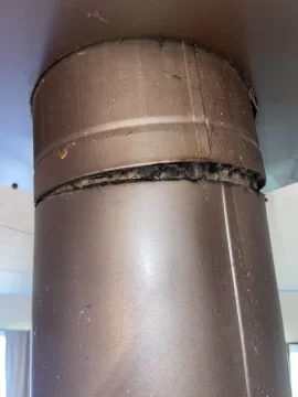

Recently had my roof replaced and after the job my outer pipe for my chimney was off center, roofers said it wasn’t a problem but recently my chimney started leaking smoke into my house at the top near the ceiling. I’m trying to work with my roofers to resolve this but they don’t think that the problem could be because of the off center pipe.
I will attach two pictures one of the base so you can see how off center the pipe is, and the second of he area that smoke is coming out. I would like to know what you guys think the cause of the smoke is and whether or not the pipe being off center is a problem. Thanks for any and all help!

That definitely is not right. The stovepipe looks like it is barely connected to the stove. The chimney and stovepipe should be plumb, not half-cocked. Can you get a level on the chimney to check this? What is supporting the chimney pipe?

There is an inner piece of the chimney coming up from the woodstove and an outer metal pipe coming through a metal flange type part that is on the ceiling.
Before the roof was done, there was a gap between the top of the stove and the pipe coming down from the ceiling. However the outer pipe was an equal distance from the inner pipe on all sides. Now the outer pipe is mashed against the inner pipe on one side. I will attach two more photos let me know if you need any more clarification - I’m new to woodstoves.
Also attaching two pictures of the level one is on that upper flange, the other is below it on the main pipe next to where the leak is.

Yes they screwed it up for sure.
Ok thanks, that’s what I thought but they want to send their chimney guy out because they don’t think it’s the roofing job that did it. How can you tell from the outside? The more I know the better so they don’t try to not take responsibility for it.
