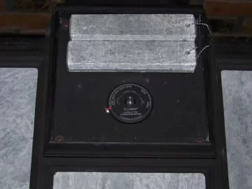

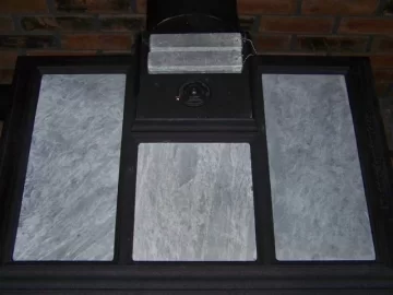

Well, the probe just arrived in the mail so I went ahead and drilled the plate and installed it. I'll leave it as is and place my boot warmers next to it. If I want to cook something on top I can just remove the probe and lay the slab of stone back over it. Looks like I got the probe about 1" from the cat, instructions say it can be as close as 1/4". I ordered the 4" stem with 2" dial, the end of the stem sits right inbetween the cat heat shield and cast iron frame so it's right in the exhaust stream.

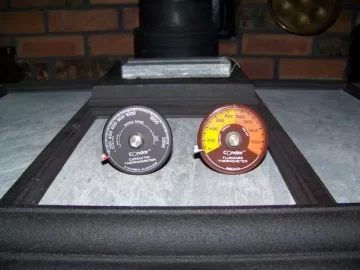

I've been doing well, hope your the same. Your right, there's been lots of testing here but they were flue probes not cat probes. I think the cat probes are calibrated differently, you can see the difference on the dial between the two. Not saying it couldn't be off but I'll figure it should be close enough and better than relying on stove top or flue temps.

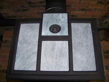

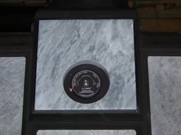

Drilled out the top soapstone so the probe sits flush. How's it look? Maybe I should of went with a 2 3/4" instead of 3". It will be interesting to see if the probe reacts different being surrounded by soapstone.
