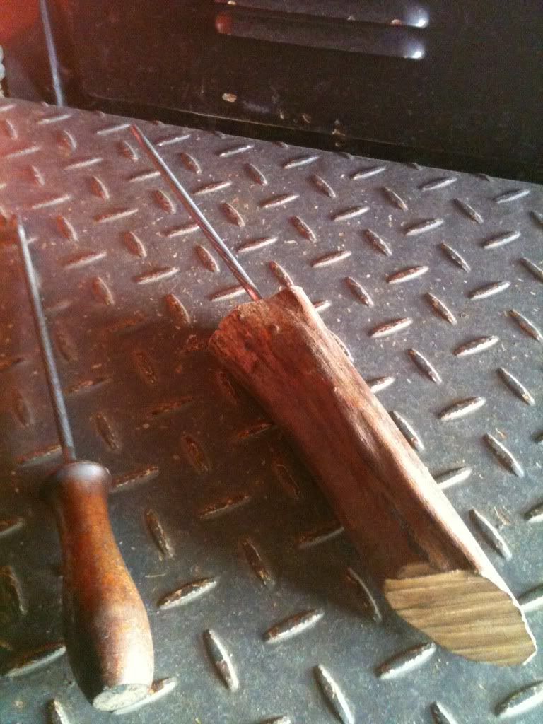

This is my solution to arthritis/joint pain while sharpening. Bigger handle and symetrically designed to fit my big paw.
I cut this out of blue beech as it has smooth tight bark that does't usually fall off even when dried. Cut it so that there was a swell (crotch) at the file end to keep my hand from slipping and the angled rear of the handle fits against the heal of my palm. The diameter is bigger so that I don't have to close my grip as far as a standard file handle. This sure makes it alot more comfy on the hands/joints to hand file. I've got 2 holes drilled in the end for round and flat files. 2nd best thing about this handle is it's FREE !
