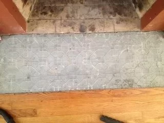

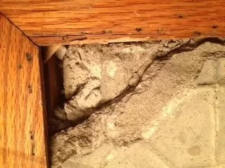

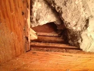

First time home owner trying to learn the ropes! 1960 floor level (slightly above after all these years) With tile. With a hammer and chisel I was able to pull up the old tile and began to work my way through what I thought was the mastic. I could not find where the concrete and mastic separated. My question is how deep should I chisel out the concrete in order to put a layer of level concrete back in. And should I put a border to the hardwood so the concrete does not run up against it?

The dimensions are ok and should up to code. Im keeping the firebox as it is and will only be burning wood in it, no Im not extending the hearth, just retiling. The main reason is to replace the existing tile which was outdated. I want to do a simple re-tile. Should I chisel down about an inch, pour concrete to level, while leaving additional space to thinset and tile to floor level?

Concrete doesn't do well in thin layers. Why are you chiseling down the existing mortar bed? Is there not enough room for the tile you want to use?
Well it wasn't all the way level, I think throughout all the years and settling. One side of the hearth was a couple millimeters above the floor while the other side was level. I could carefully chisel a couple millimeters below the hardwood but it would be difficult to make it smooth and level to lay the tile on?
You don't really need it smooth and even, you just need enough room for the tile and thickness of the stuff you use to stick the tile down (which is typically thinset mortar, and is definitely NOT mastic.) Variances in depth are made up by varying the amount of thinset you use; it's plenty stiff enough to float the tiles on.
Thinset mortar has a maximum layer thickness, I think somewhere around 5/16". If you need to go thicker, there's a similar product called medium bed mortar that is good up to about 3/4" thickness.
If you have more chiseling to do, try not to crack that mortar bed you're working on. If you break it then you'll have to pull it out and redo the whole thing, or the crack will telegraph through your new tile.
