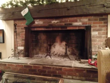

This is it, 60 inches wide by 29 inches high with the damper about 35 inches high.
That is a big opening. Maybe put in 2 inserts for stereo viewing :) or more likely consider another location for a stove and keep the fireplace for holiday fires.
There isn't really a good spot for a separate stove in the room unfortunately. Does the Clydesdale have the largest viewing window of any insert, and if so what are the window's dimensions?
(broken link removed to http://www.hearthstonestoves.com/store/wood-products/wood-inserts/clydesdale-wood-insert)
Too bad it is wide but short. A Hearthstone Equinox would rock, pun intended, in that hole but it is too tall.
