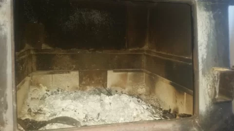

I measured the interior of the firebox to be 17x18x21". Seems to smolder most of the time (maybe because its cottonwood), which i dont know if thats a problem.

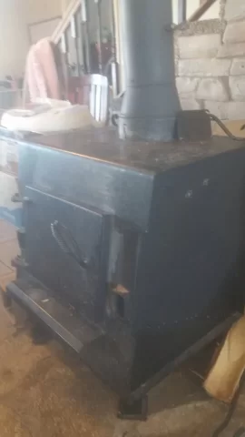

I am thinking of replacing my stove with a BK, since mine is from a manufacturer in Montana that no longer exists (LA stove from Filson), but since I never have owned a wood stove before, would I be wasting money to swap this out?
14 hours of burn time seems high, but not sure due to conditions I listed.

Sounds like a decent stove based on the burn times. We see very little about the LA stove. Could you post some pictures of it? Interior pictures of the stove would also be helpful.
There were several old designs that smoldered wood. They earned the nickname of smoke dragons. Modern stove designs are made to burn cleanly. In order to burn smoldering wood cleanly, Blaze King uses a catalytic combustor which chews through the smoke and burns the wood gases. They add a thermostat to keep the stove producing a steady heat level, based on the user setting. This not only dramatically reduces emissions, it also greatly increases efficiency over old designs so that less wood is burned for the given amount of heat.
  • [Hearth.com] Do I have good stove? Can run for 14+ hours on a single load of cottonwood.
The beast;lol
That's a really large unit. One big old box of heat! I'll reserve comment on replacement as it sounds like you are a hit and miss pleasure burner at this juncture. Just don't fall into that thing while loading.
The long burn is coming from the sheer volume of the box. There are not many fireboxes of that size, but for comparison a Blaze King King is close. It can achieve 30+ hr burns on a regular basis. But it does have a layer of technology (the cat) to accomplish this. If simplicity is the goal then the Drolet HT3000 or Austral III may be a better bet.

If that is really you criteria stick with what you have it is simple and pretty indestructible. Is it a good stove? In my opinion no but if your main concern is something that will work no matter what it fits the bill pretty well. But I wouldn't use it to heat my house

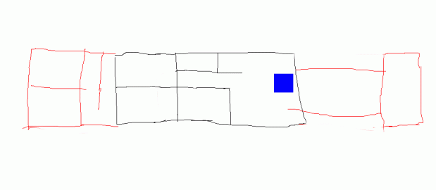

What's the size and layout of the house?

Layout:
Blue is stove. Red is upstairs. I called BK and sent them a video of house and he thought Princess would be fine, but of course, good to get multiple opinions. Surely my proportions are off (not as long as+ seen).
P.S. I failed art class
