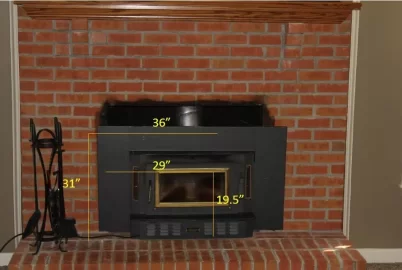

Greetings,
I recently purchased a use Appalachian Stoves 30CD. I had it installed along with a new liner and cap in my chimney. My fireplace is a bit larger than the stove - even with the face plate. Since the face plate was too small - I removed it. Outside of aesthetics, what value/utility does it provide? I have porvided a picture of the stove with measurements.
Please share your thoughts comments.
Thanks!

The surround can be left off. Is the insert installed with a full liner (to the top of the chimney) and is that a stainless elbow coming off the flue collar?
Well, you need a bigger faceplate, search for that... Gl
I would look tons better if you just got the bigger panels. See if you have any local dealers that might be able to fix you up with the parts that you need.
begreen - The stove does have a stainless elbow, complete liner with cap at the top. I am not having much success finding a faceplate to fit my stove with the large fireplace opening. After removing the pieces of the existing faceplate, I really do not see much funciton behind it besides a physical barrier to hide the fireplace. Am I missing something?
No, I don't think so. IMHO the faceplate is indeed more for aesthetics than actual function. However, one thing to consider: Is the back of the fireplace going to another room or the outside? Some people here noticed an improvement with heat output when putting Roxul around the walls of the fireplace when having a fireplace that has exterior walls. But that may really not look good without the faceplate.
Another point: To reduce heat loss up the chimney did you install a block-off plate? It will greatly reduce the amount of warm air going up the chimney. Here is a great article how to make one: https://www.hearth.com/econtent/index.php/articles/making_a_block_off_plate/
Sounds good. The main thing the surround is doing is cosmetic in this case. You could have a sheet metal shop cut you up an extension piece and paint it black to match the existing surround. Have them hem the edges if you do. Or leave it off.
