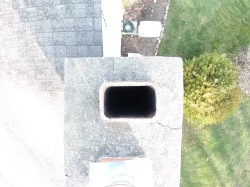

Sweep guy said my Terra-cotta lining was starting to degrade and my chimney crown had a crack in it. Will need to pit in a liner and have the crown replaced next year for the Oil Side. They will put a single top cap on and waterproof at that point.

So he showed me the pitting of the lining in real time on a camera where the furnace connects. Attached is a Drone photo of the cracks in the crown. Maybe Bholler can see something on that Since he is a Sweep

Yeah looks like typical crown without an expansion joint around the liner. It needs replaced
