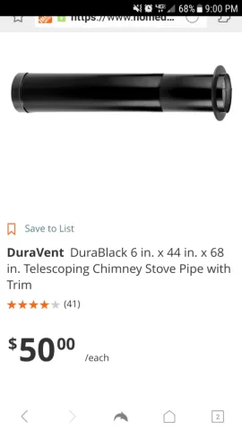

I'm planning out my install for a Englander 30 and it happens to come right to 68" from stove flue collar to ceiling box. I was wondering if the adjustable 44-68" actually go the whole way?

Male end down, make sure you're measuring to the furthest point. You have to go inside the collar on the top of the stove....and the ceiling box should have the male/crimped end facing down to slide the pipe over.
Maybe I misworded the question.
Does the advertised "68" inches actually cover 68" leaving extra for slipping into and over, or is that from pipe end to end?

I understand the question but I'm suggesting that you measure twice to be sure and then even at that, if it's that close I would not risk it and use a second piece. That's just me. I don't know that specific product or how they mark their product but I would doubt that there would be extra for the connections themselves. If I had to guess I'd say 68 is the maximum, end to end. If you need another 2 inches for slipping inside the stove you'd be out of luck.
Thats gonna be tight. If you are looking at high end pipe with good warranty, like $200 retail, i would expect it to extend to 68 usable inches. Bargain basement stuff, not so much.

Ventis Black single wall Telescoping pipe says 38" to 70", each pipe is 36" in length

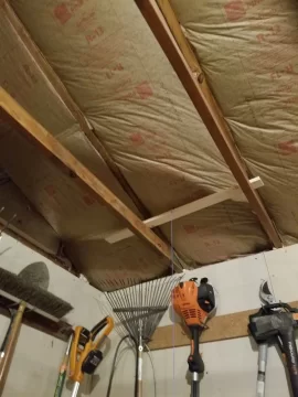

Here is a shot of the roof I'll be going through. It's approximately 115" to bottom of truss. So I'll need the "Through the ceiling kit", 2 pieces of 6x36 triple wall then ~68" of single wall to go from flue collar to ceiling support box.
That would work out good. I like the idea of heavier gauge, do you know if it matches up to the Duravent ceiling kit?
Unlike Class A pipe, I believe that Single wall pipe is universal and will connect to any single wall adapter.
